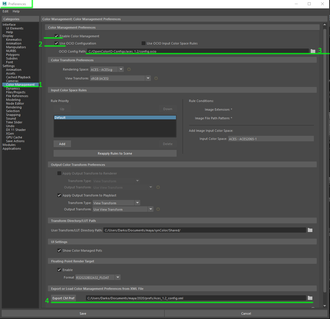

ACEScg
New in V-Ray is support for the ACEScg color space. I tend to use ACEScg in all of my projects across many different renderers, so this was a highly anticipated feature from my side.
The first step was to set up ACEScg to work correctly in V-Ray 5 for Maya. In Maya’s preferences, I went to color space, and I turned Use OCIO Configuration ON. Then, I loaded my OCIO config file, which in my case was ACES_1.2. I scrolled all the way down to Export CM Pref, and I exported .xml file, ensuring that OCIO loads every time I start Maya for all the render engines I have installed.
Product Manager's note: As of update 1.1, V-Ray 5 for Maya now automatically synchronizes the VFB's OCIO display with Maya's Color Management settings.
After that, in the VFB, under Display Correction, I switched from RGB to OCIO. In the OCIO file, I loaded the same ACES_1.2 config.ocio file, I set Input Color Space to ACES - ACEScg, Display Device to ACES and View Transform to sRGB. You can also create an environment variable to have this set every time you open the VFB.
