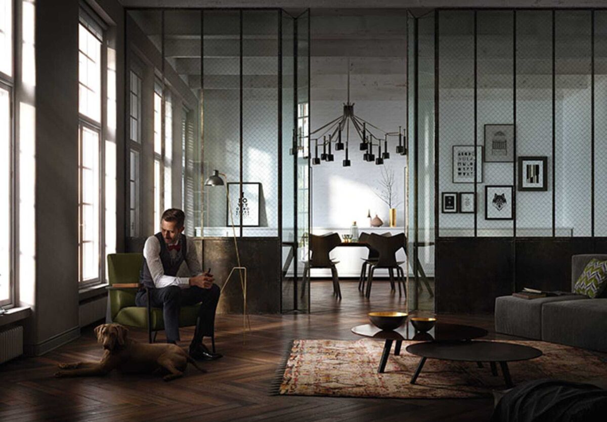

4. Turn on the bright lights
Light design is an integral part of interior design. Light can literally make or break a design, so it can’t be neglected.
As we did with the sun, we have to check all artificial light sources and see if they can contribute to our design, making it more appealing or even more dramatic, perhaps. For this task, you can choose from a variety of light types, where the V-Ray Light (that can take different shapes such as rectangle, disc, sphere and even complex geometries that act as light objects) and the photometric light are the way to go when it comes to interiors. Using a point light may not be a great idea here, as it is probably the least realistic light type available in a 3D software and the light produced by this kind of light doesn't offer the same controls you'd get with area lights, for example.
Choose the light that best approximates the actual light in the design and place it just like the real thing.
And then, we have our second tip: you don’t need to turn all the lights on. Use the artificial light to paint your scene with both light and dark and color. For example, you can balance the blue light that comes from the window with some warm light coming from a floor lamp. Play with the light, its color and intensity so you can better tell your story. For that intent, directional lights can add interesting contrasts and highlights as well.
You can also think as a real photographer and use spot lights and area lights to mimic studio lights and add some extra flavor to your lighting.

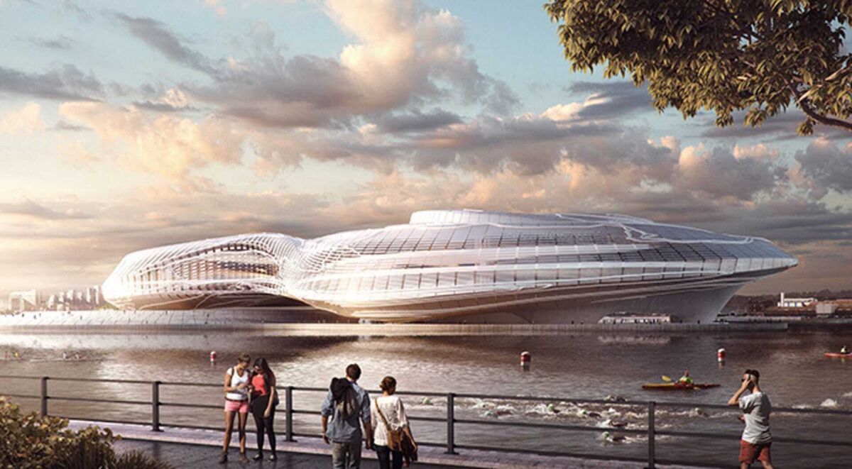

Bonus track: Here comes the sun
Rendering an outdoor scene might sound more straightforward than interior ones, but it often presents unique challenges. While indoor scenes typically benefit from multiple light sources, outdoor scenes rely on fewer, natural sources of light. This limitation means there are fewer opportunities to "trick" the viewer into perceiving realism, making it crucial to not only use the right tools but also apply them skillfully.
Rockin' in the Free World
Firstly, we introduce a V-Ray Light Dome to simulate skylight, accompanied by a V-Ray Sun. This combination is particularly powerful, capable of creating realistic skies complete with clouds, contrails, and light dispersion. These elements contribute to the overall lighting, enhancing the believability of the sky while offering comprehensive control of the final outcome. For a detailed guide on utilizing this setup, check out this tutorial:
A pro tip is to leverage V-Ray IPR for iterative adjustments to the sky's appearance. The real-time feedback provided by IPR, coupled with the creative latitude afforded by the V-Ray Sun/Sky system, forms an ideal toolkit for achieving unparalleled realism in outdoor scenes.
