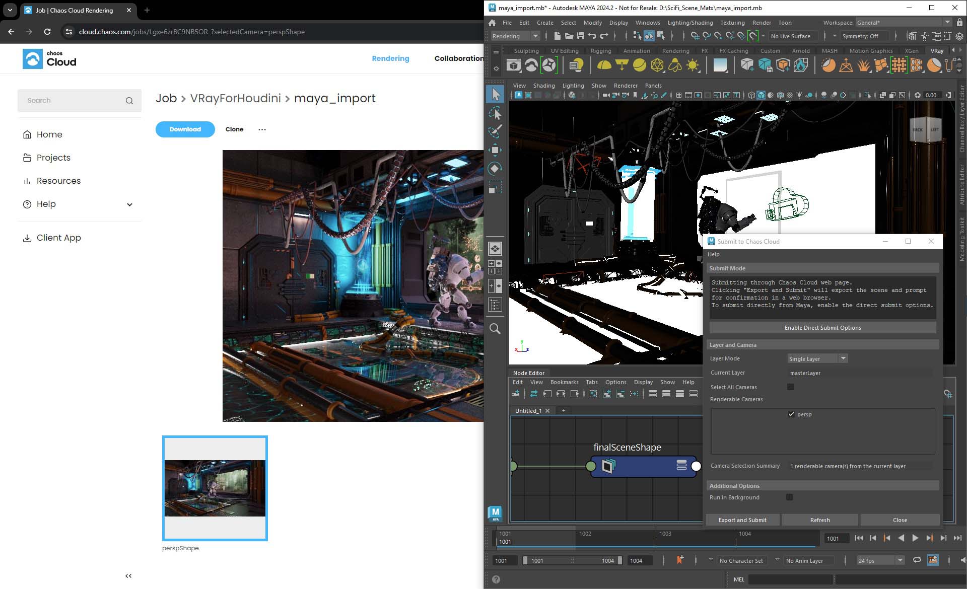

The V-Ray Standalone integration of MaterialX allows artists to generate a scene description from their favorite Digital Content Creation (DCC) tool and render it through the command line or via Chaos Cloud Rendering, independently of the DCC used for scene generation – thus optimizing studio workflows and license costs.
We built a reusable translation layer that is used to read MaterialX graphs in our integrations, which means that V-Ray and V-Ray Hydra can now interpret the same number of MaterialX nodes, and support is consistent. The added benefit of the shared translator is that it also equalizes the reading and rendering of USD data between V-Ray for Maya and Solaris.
sci fi scene rendered with v ray in maya alongside chaos cloud submission interface showing render workflow
USD data in a scene rendered in Chaos Cloud
V-Ray for Maya, which is closely based on V-Ray Standalone, gets the same level of support for any MaterialX shader loaded in a USD stage. V-Ray also supports the LookDevX editor in Maya, where artists can create MaterialX graphs and push them to a USD stage or read and modify graphs loaded from a stage with interactive updates in V-Ray IPR.

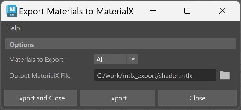

V-Ray shading graphs can be exported to .mtlx files directly from Maya too.
maya export materials to materialx dialog window showing options for selecting materials and output file path
Lastly, V-Ray 6.2 can load .mtlx files and apply the contained material to any object in the scene outside of the USD stage, making it possible to use any MaterialX library of materials that a user gets access to. In most integrations, the VRayVRmat material can be used just as well as the MaterialX material in 3ds Max or the new VRayMaterialX node in Maya.
