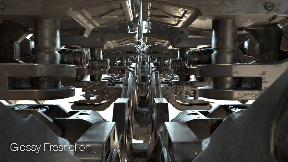

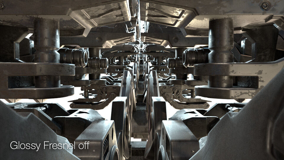

Here is a practical example of the Glossy Fresnel effect turned on and off.
For the most part most people will simply notice that the overall reflection is dimmer. However, because Glossy Fresnel is more physically accurate, it will actually be closer to reality and therefore better overall at matching reference.
