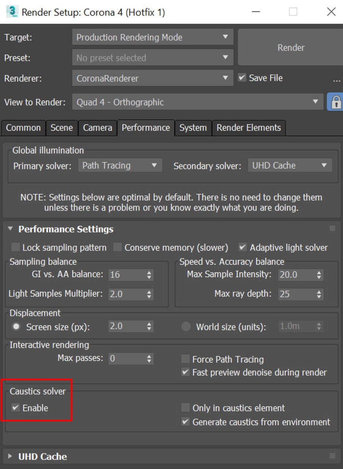

How simple was it to add the caustics? Can you walk us through any tweaks you made to get the final result, or was it pretty much left at default?
Adding caustics was surprisingly simple by basically just changing two settings: Enabling refractive caustics in the water material options and enabling the caustics solver in the render settings. No tweaking or postproduction needed.
The render settings for the Recent Spaces’ scene

One thing we discovered was that you do need to give some extra thought to the scene set up if an area of the water is off-camera, but ought to be reflecting caustics into an area visible in the camera. When using displacement with the default Screen Size option, then displacement is not calculated for anything off camera, and that leaves that part of the water flat – which means no interesting caustics from that area. In such situations, using World Size instead of Screen Size can be useful, or even necessary, as that calculates displacement equally for everything in the scene whether it is in the camera view or not.
We discovered that sometimes you can manage the potential increased memory requirements when using World Size displacement by using a CoronaDisplacement modifier set to World Displacement for the water alone, leaving the rest of the scene using Screen Size. Either way, it seems like a fair trade to get the desired result from the caustics. (Editors note: the new 2.5D displacement and memory savings in Corona Renderer 5 should help offset memory requirements too)
