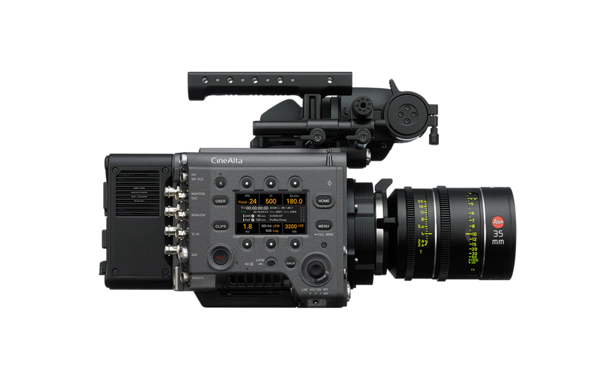

Professional CineAlta digital cinema camera with a Leica 35mm lens, designed for high-end film and television production.
Sony’s Venice motion picture camera system is one of many that support an ACES workflow. © Sony Pro
The problem is that those raw formats are not compatible with each other. So the Academy came up with a new modern color encoding system (ACES) to put all the camera data in the same color space. This made it much easier for colorists to keep consistency across many different sources.
