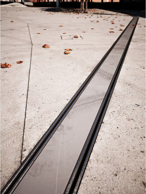

Tip 3: Take advantage of displacement
V-Ray’s displacement is a fantastic and sophisticated tool. Different options are available and all of them have their strengths. For example, with large surfaces that are more or less flat, we can use displacement in 2D mode. This will give us great details without using too many resources, and the setup takes very little time.

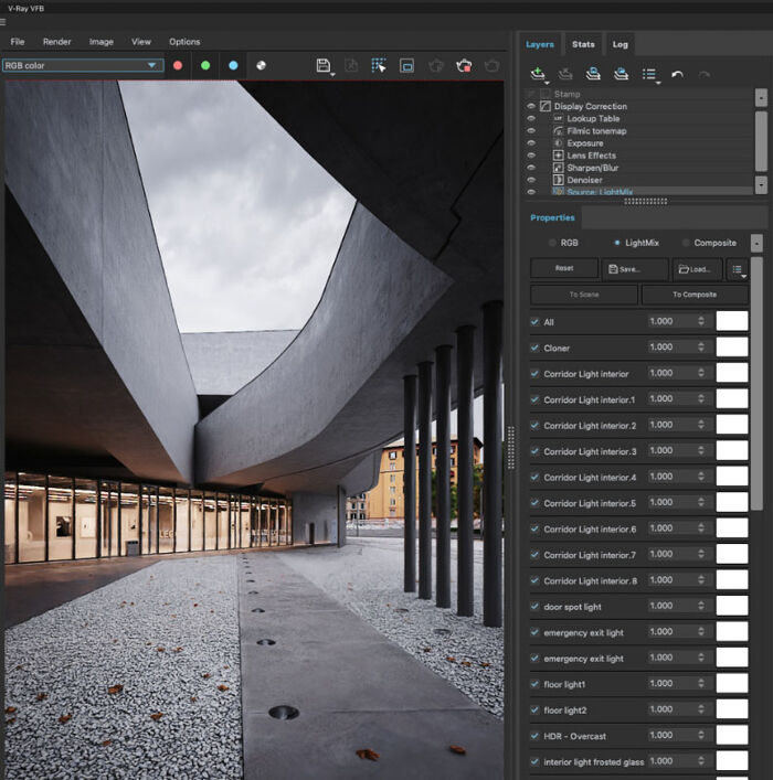

Tip 6: Relight with Light Mix
Nothing beats the Light Mix tool when you need to test out different lighting solutions. Well-balanced lighting is always essential to start with, but with Light Mix, you can make small or dramatic changes to light in real-time without having to re-render.
blog-lightmix
© 3D Render & Beyond

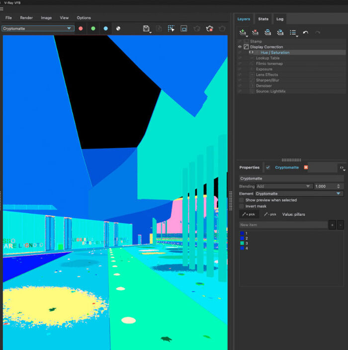

Tip 7: Change up the look with Cryptomatte
Just as Light Mix can modify lights in real-time, Cryptomatte enables us to modify shaders’ colors and much more. With this tool, you can create an unlimited number of masks that can be used to change the look of single elements of your render. You can do all this without having to use any other editing software, which speeds up post-production quite a bit.
cryptomatte in V-Ray
