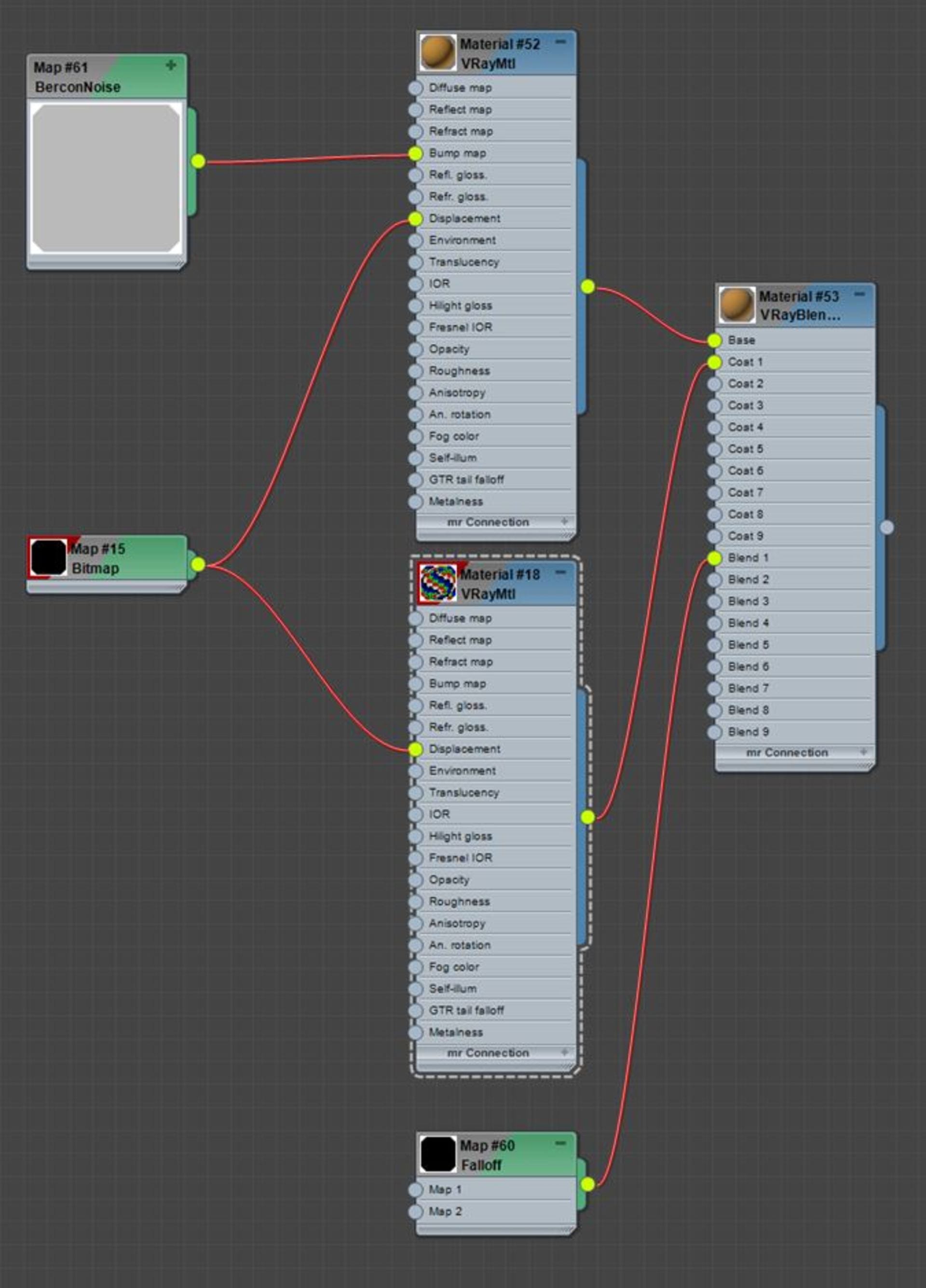

Hermunpreet
I created the materials as a mix between car paint and a balloon, with the reflectivity of the car paint and a plastic feel of a balloon. I used a V-Ray Material as a base, with only a colour and a tiny amount of bump to create a wobble in the paint.
Hermunpreet's materials setup
The next step was to create the reflection, I tested multiple materials with different amounts of glossiness and scratch bump values. But this looked visually too busy so I settled on just one coat material on the base layer with a falloff map.
It sounds simple, but there was a lot of back and forth, rendering and adjusting. As the whole car was a single object, we created the details in the materials. Examples of this include the bonnet vents or the fuel caps, where we used masks and non-reflective black materials to give the appearance of holes.
